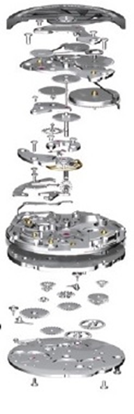

Structure of a Mechanical Watch Mechanism
