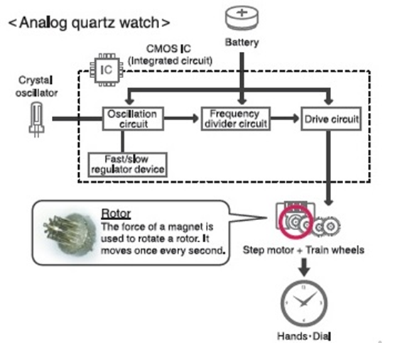

A quartz watch is powered by a battery and uses an electric signal to move the hands. This electric signal occurs every second and is created by the vibration of a quartz crystal oscillator which is controlled by an integrated circuit. This works at an accuracy of +/- 15 seconds per month.
